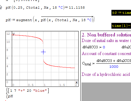

#1 Posted: 7/10/2018 7:33:33 PM
Works fine.
Inst_pH Solution.sm (24.51 KiB) downloaded 1211 time(s).
#2 Posted: 7/10/2018 11:36:55 PM
Works fine.
... refreshed, optimized calculation timing
Added the buffered plot to be splined for + values.
Inst_pH Solution.sm (44.9 KiB) downloaded 1244 time(s)....refreshed/augmented

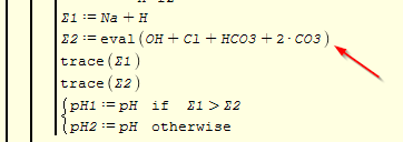

#3 Posted: 7/11/2018 4:42:18 AM
Hello Jean,
For me, the first plot is working
but the second is not - cases() is complaining.
I could see that sigma2 went nuts (do not know why) and put eval() in front of it
I do not have the explanation of this - might be a bug.

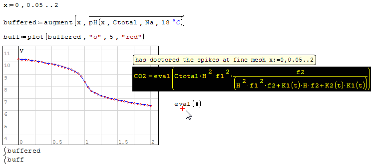

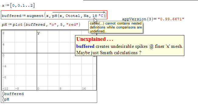

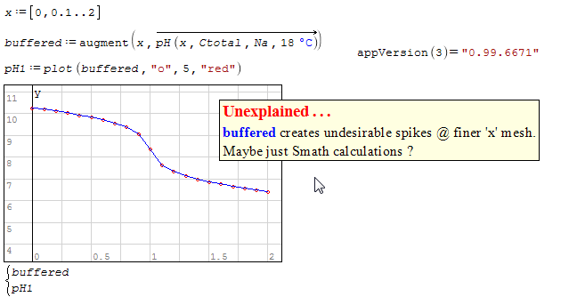

#4 Posted: 7/11/2018 8:09:43 AM
1. Can't understand the error cases(,) [6671]
2. Make unit K was first problem , done well.
3. Doctoring for the spikes works and accelerates calculation timing.
Inst_pH Solution Copy.sm (46.65 KiB) downloaded 1259 time(s).
