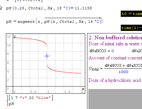

... refreshed, optimized calculation timing
Added the buffered plot to be splined for + values.

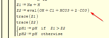

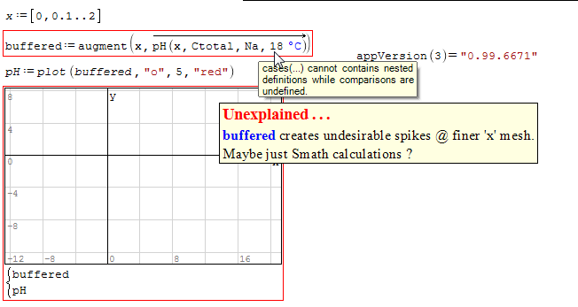

For me, the first plot is working
but the second is not - cases() is complaining.
I could see that sigma2 went nuts (do not know why) and put eval() in front of it
I do not have the explanation of this - might be a bug.

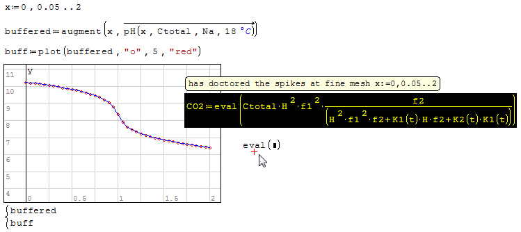

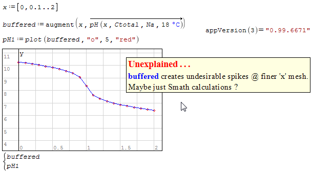

1. Can't understand the error cases(,) [6671]
2. Make unit K was first problem , done well.
3. Doctoring for the spikes works and accelerates calculation timing.
Inst_pH Solution Copy.sm (46,65 КиБ) скачан 1259 раз(а).
