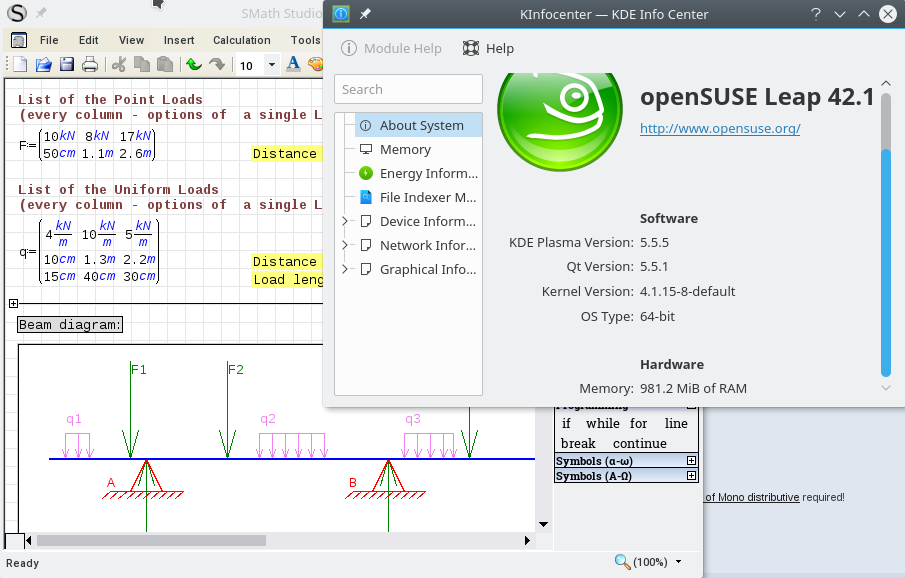

#3 Posted: 3/22/2016 6:58:17 PM
2273 likes in 3738 posts.
Cannot reproduce.
Just tested latest SMath Studio 0.98 (RC4) with latest Mono on fresh openSUSE. Everything works fine (complex worksheets, different plug-ins, etc.)
