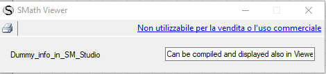

the new Header Region implemented in 6884 ( ) does not allow to see or modify the included text when Viewer U.I. is used.
Info gets printed when printing directly from Viewer, so it is there in Viewer, but hidden.
Same file, in Studio: header content can of course be viewed and modified.
It would be a useful feature for me, to have some control on text definitions contained in the Header also from Viewer UI.

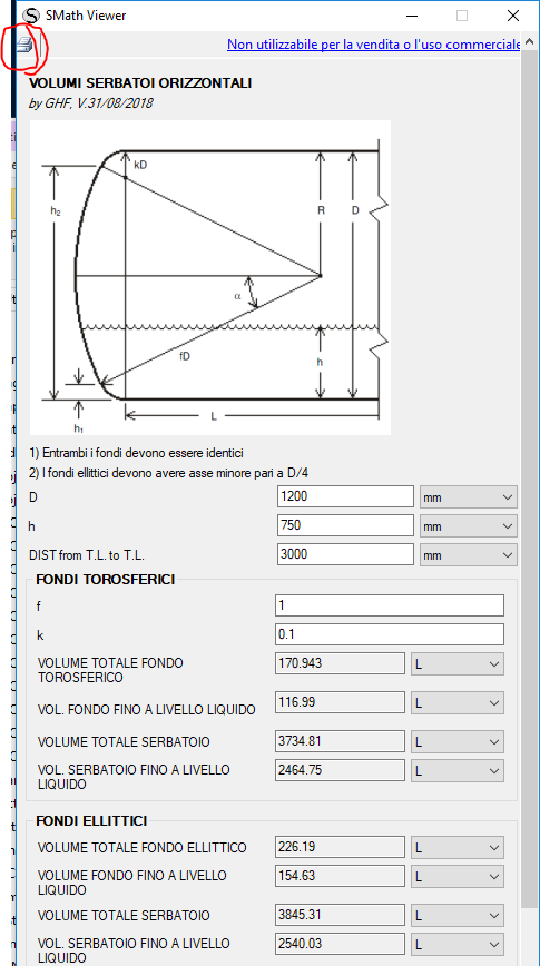

Now, I can't upload an .exe example via SMath forum, so I'm sharing a dropbox link to the .exe file, in case you're interested in seeing the kind of tools I'm referring to.
Still did not have time to finalize this file though; infact, hiding of undesired outputs has not been finalized,, every description is still in italian, logo is missing, and all that Quality stuff we discussed above is missing too... (this file was more of an excercise for me)
By the way: common but annoing task, to define liquid volume in horizontal pressure vessels as a function of geometry and liquid height.
A lot of charts are available out there for specific shapes of dished heads and specific diameters, but sometimes having the analytical tool can help.
To see a pdf of the underlying code, just print it to pdf.
