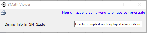

the new Header Region implemented in 6884 ( ) does not allow to see or modify the included text when Viewer U.I. is used.
Info gets printed when printing directly from Viewer, so it is there in Viewer, but hidden.
Same file, in Studio: header content can of course be viewed and modified.
It would be a useful feature for me, to have some control on text definitions contained in the Header also from Viewer UI.

In SMath Viewer user interface, newly available (SS6884) custom Header and Footer data cannot be modified, up to now.
Hopefully, they will be accessible in the future from Viewer itself.
