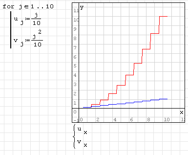

this is what I have now.
[albumimg]340[/albumimg]
By chance, is there any way to have the plot connect the data points with a line segment between points rather than having this stepped look? If so, it would easier to see the slope of the curve at the various divisions along the way.
#4 Posted: 1/21/2014 6:16:57 PM
1,357 likes in 2,271 posts.
Yes, of course. See the attached handbook pages.
