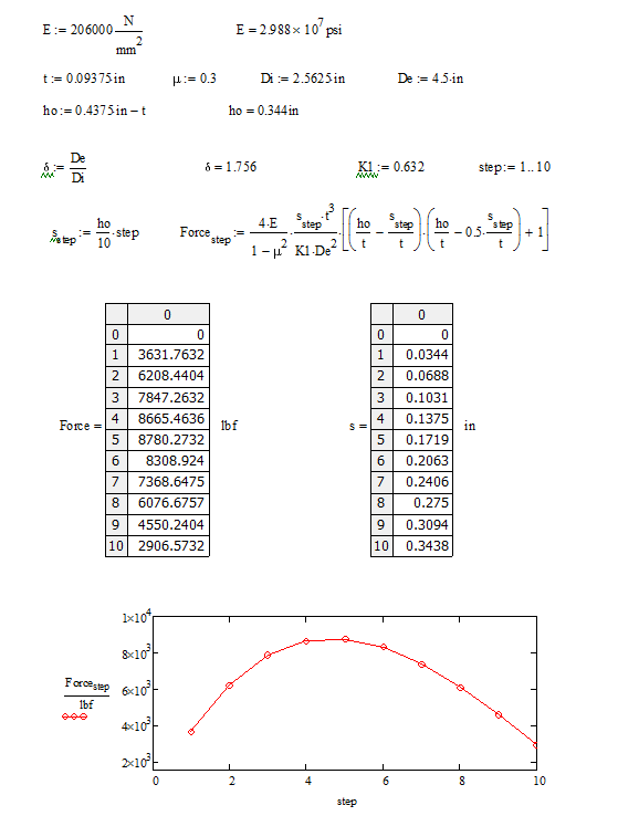

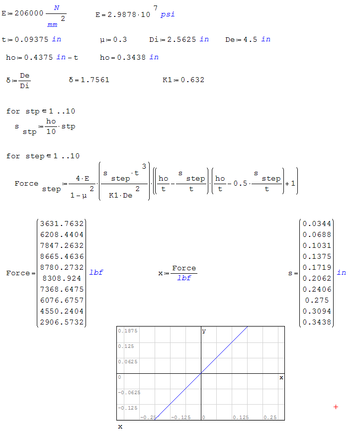

Here I post what I have done in MathCad and what I try in SMath.
issue 1: I need help in defining the plot value for SMath.
issue 2: I also need help in how to define two or more expressions within one for loop.
Thank you,
Jay
#2 Опубликовано: 21.01.2014 12:52:41
I would like to plot the vector values on the Y axis against the vector index on the X axis.
Just use x as index.
Use the line() function (programming palette) to set up blocks of expressions.

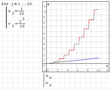

this is what I have now.
[albumimg]340[/albumimg]
By chance, is there any way to have the plot connect the data points with a line segment between points rather than having this stepped look? If so, it would easier to see the slope of the curve at the various divisions along the way.
#4 Опубликовано: 21.01.2014 18:16:57
Yes, of course. See the attached handbook pages.
