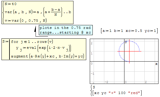

#5 Posted: 10/13/2018 6:52:41 PM
How to Plot circle using Radius and location of center ?...
From native maths in native Smath.
#6 Posted: 10/13/2018 7:44:46 PM
... code it as a generalized companion utility.
Circle Complex.sm (14.32 KiB) downloaded 1210 time(s).

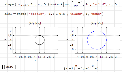

#7 Posted: 10/13/2018 7:52:19 PM
... enjoy the magic circle aperture.
Circle Magic Disk.sm (16.83 KiB) downloaded 1273 time(s).
