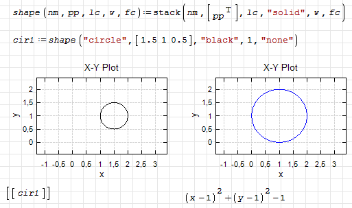

Hi. Without doubts Viacheslav use of him plugin is the better solution. But here some examples about how to setup the plot of a parametric curve using native SMath plots.
circle.sm (30,39 КиБ) скачан 1246 раз(а).

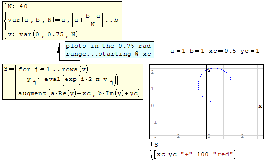

How to Plot circle using Radius and location of center ?...
From native maths in native Smath.
#6 Опубликовано: 13.10.2018 19:44:46
... code it as a generalized companion utility.
Circle Complex.sm (14,32 КиБ) скачан 1210 раз(а).
