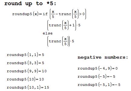

Hello Destory,
Apart from the Ceil function, you can write your own function for this, i have made an example for you:
example
you can edit the function (extra if loop) if you want it to handle negative numbers differently.
ceil_and_roundup_to_5.sm (7.7 KiB) downloaded 2199 time(s).
I hope this helps you.

The image:

Here is the working program for n=5
A bit confusing for n ≠ 5
Utilities Matrix roundup_n.sm (10.19 KiB) downloaded 1963 time(s).
