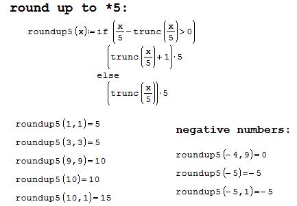

Apart from the Ceil function, you can write your own function for this, i have made an example for you:
you can edit the function (extra if loop) if you want it to handle negative numbers differently.

Here is the working program for n=5
A bit confusing for n ≠ 5
