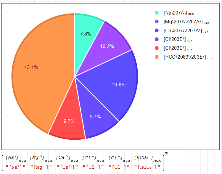

How we cam correct format the pie-diagram? Not 1 2 3 4 5 6 but with names of ions.
I would like to see a diameter - cation summa = anion summa.
Pie-diagram.sm (18.37 KiB) downloaded 1552 time(s).

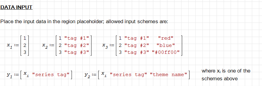

Hi
you have to add a second column in the data matrix with the names, otherwise a progressive number is used by default.
From the documentation...
![2023-12-15 13_43_52-SMath Solver - [PieChartRegion.sm_].png](/en-US/files/Download/SeaUkd/2023-12-15-13_43_52-SMath-Solver---[PieChartRegion.sm_].png)
BTW I see there is not yet text decoding, I'll fix it soon.
![2023-12-15 13_36_04-SMath Solver - [Pie-diagram.sm_].png](/en-US/files/Download/Xnvna5/2023-12-15-13_36_04-SMath-Solver---[Pie-diagram.sm_].png)

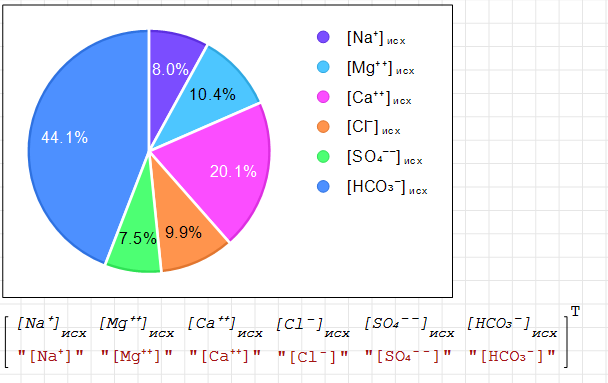

WroteBTW I see there is not yet text decoding, I'll fix it soon.
Fixed, plugin update released.
![2024-01-05 12_24_14-SMath Solver - [Pie-diagram(3).sm_].png](/en-US/files/Download/GBF4ET/2024-01-05-12_24_14-SMath-Solver---[Pie-diagram(3).sm_].png)
Pie-diagram_legend.sm (18.85 KiB) downloaded 1487 time(s).

WroteFixed, plugin update released.
Superb Davide ! ... Color Wheel ...
Thanks, Jean
