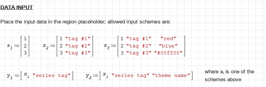

you have to add a second column in the data matrix with the names, otherwise a progressive number is used by default.
From the documentation...

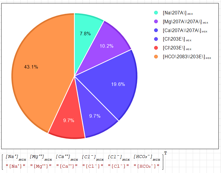

BTW I see there is not yet text decoding, I'll fix it soon.
![2023-12-15 13_36_04-SMath Solver - [Pie-diagram.sm_].png](/ru-RU/files/Download/Xnvna5/2023-12-15-13_36_04-SMath-Solver---[Pie-diagram.sm_].png)

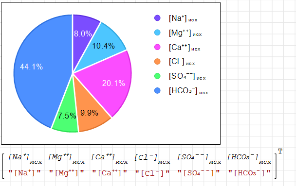

Fixed, plugin update released.
![2024-01-05 12_24_14-SMath Solver - [Pie-diagram(3).sm_].png](/ru-RU/files/Download/GBF4ET/2024-01-05-12_24_14-SMath-Solver---[Pie-diagram(3).sm_].png)
