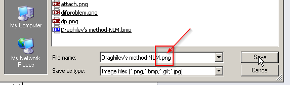

Did you follow these steps?
1. Open an SMath file
2. Select "File|Save as..." from the main menu
3. In the "Save as type" select "Image files (*.png,*.bmp,*.gif,*.jpg)"
4. In the "File name" add one of the four above mentioned extension
See the picture please. I just add the extension ".png" to point out the file will be saved in PNG format
