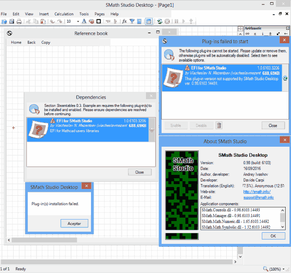

SMath Forum SMath Studio Bugs & Problems EFI plugins load 1 Pages (5 items) EFI plugins load - The EFI plugins for Smath Studio not start - Messages Go to last post #1 Posted: 9/16/2016 1:32:09 PM CBG 78 likes in 312 posts. Group: User The EFI plugins for Smath Studio not start in version 0.98.6103 of Smath Studio.Best RegardsCarlos #2 Posted: 9/16/2016 1:47:22 PM Вячеслав Мезенцев 1,555 likes in 1,866 posts. Group: Moderator Yes, I can't setup the assembly correctly. Do not use the latest builds. They marked as beta. I need a few days to solve the issue. Russia ☭ forever, Viacheslav N. Mezentsev #3 Posted: 9/18/2016 2:46:05 AM Вячеслав Мезенцев 1,555 likes in 1,866 posts. Group: Moderator Updated. Try now. Russia ☭ forever, Viacheslav N. Mezentsev #4 Posted: 9/19/2016 3:31:09 PM CBG 78 likes in 312 posts. Group: User Thank you very much, now, EFI Plugin load very good, but it does not workBest Regards.Carlos #5 Posted: 9/19/2016 10:36:16 PM Вячеслав Мезенцев 1,555 likes in 1,866 posts. Group: Moderator And what about 32-bit flag? You can use CorFlags to set it manually. Russia ☭ forever, Viacheslav N. Mezentsev 1 Pages (5 items) New Posts No New Posts
