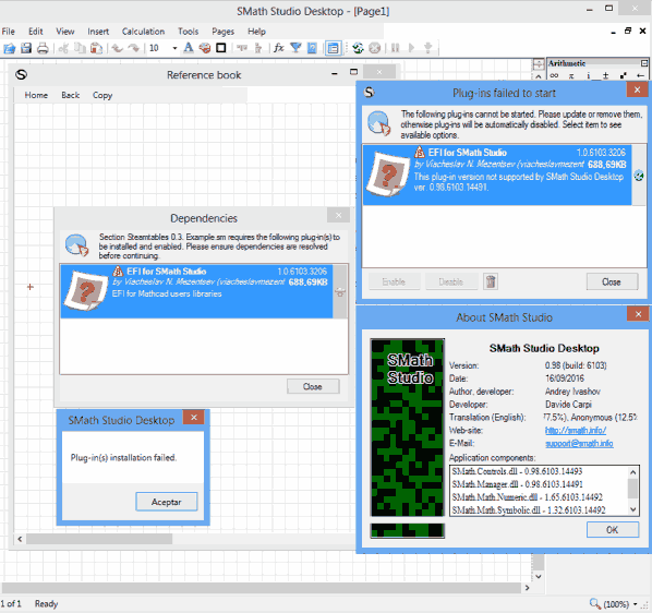

The EFI plugins for Smath Studio not start in version 0.98.6103 of Smath Studio.
#2 Опубликовано: 16.09.2016 13:47:22
1 411 сообщений из 1 711 понравились пользователям.
Yes, I can't setup the assembly correctly. Do not use the latest builds. They marked as beta. I need a few days to solve the issue.

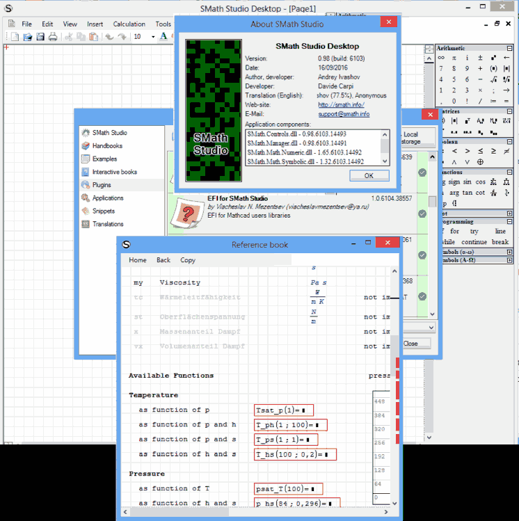

Thank you very much, now, EFI Plugin load very good, but it does not work
Best Regards.
