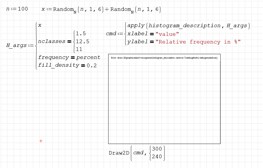

histogram_description error
It worked fine last time.
but today it doesn't work.
What's the problem?

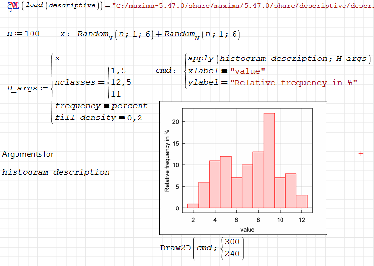

#2 Posted: 5/22/2024 2:45:17 PM
1,346 likes in 2,259 posts.
This function is part of the Maxima package “descriptive”. It must be loaded before using the command, just as with boxplot_description, where this is mentioned in the handbook. For histogram_description I forgot to mention this.
