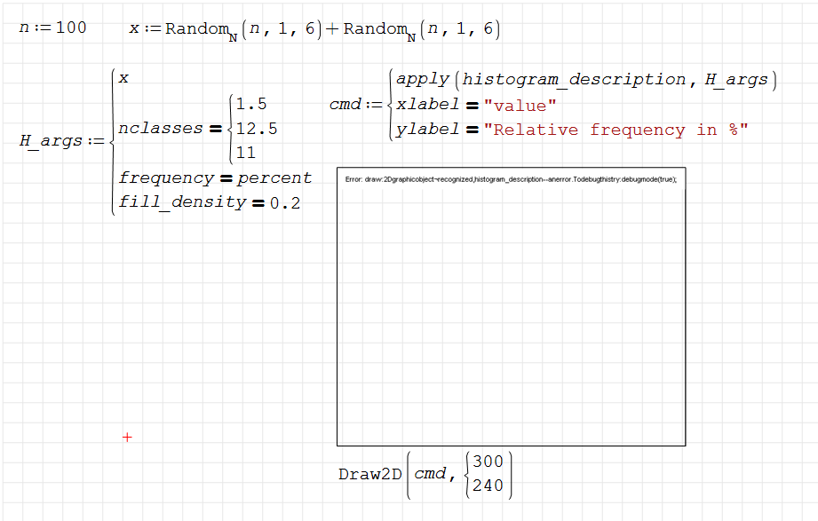

histogram_description error
It worked fine last time.
but today it doesn't work.
What's the problem?
histogram_description.sm (7,68 КиБ) скачан 1555 раз(а).

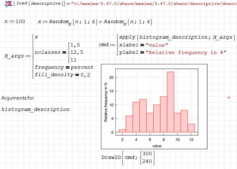

This function is part of the Maxima package “descriptive”. It must be loaded before using the command, just as with boxplot_description, where this is mentioned in the handbook. For histogram_description I forgot to mention this.
