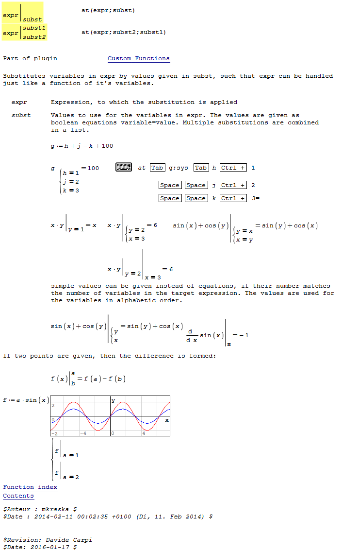

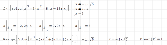

#4 Posted: 6/7/2023 3:19:06 PM
Handbook page for at() and Solve(). at() is a convenient alternative for Assign(), which creates assignments based on equations (as returned by Solve, ODE2 or Fit())
at.sm (22.23 KiB) downloaded 1366 time(s).
_Solve.sm (33.17 KiB) downloaded 1388 time(s).
