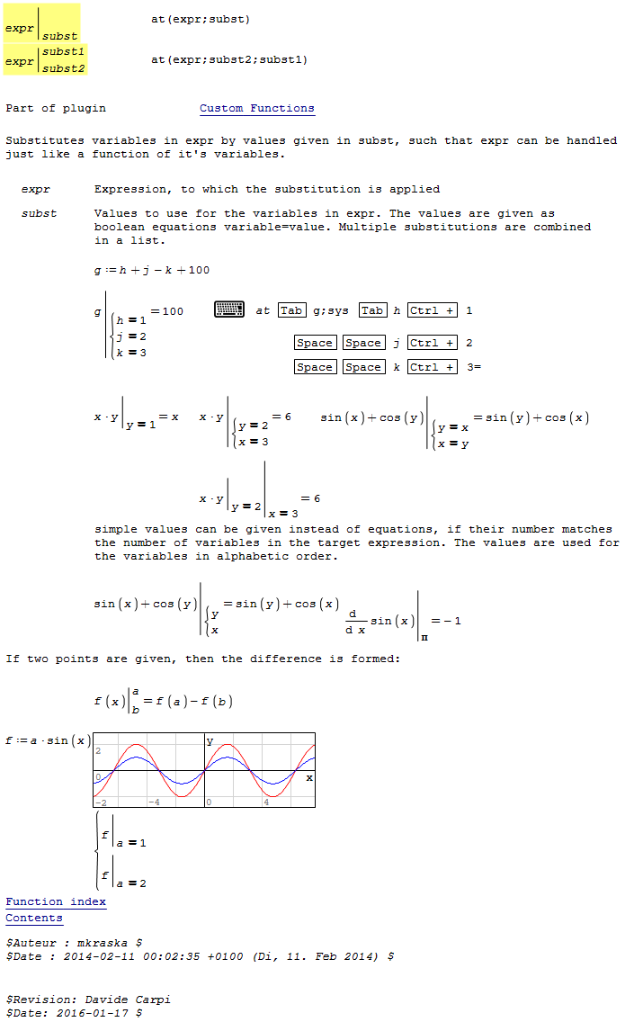

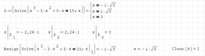

Handbook page for at() and Solve(). at() is a convenient alternative for Assign(), which creates assignments based on equations (as returned by Solve, ODE2 or Fit())
at.sm (22,23 КиБ) скачан 1366 раз(а).
_Solve.sm (33,17 КиБ) скачан 1388 раз(а).
