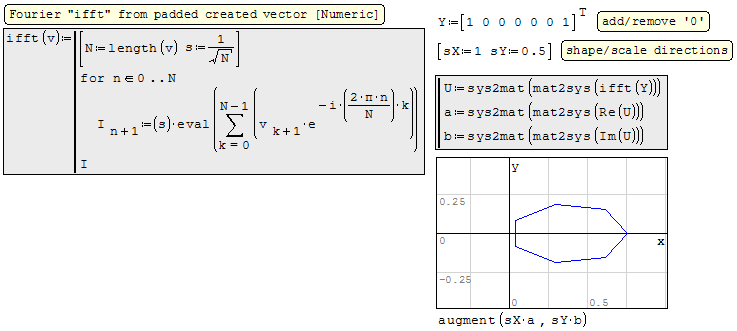

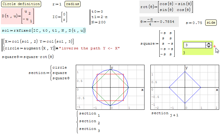

#5 Posted: 5/9/2019 2:43:25 PM
If I choose Rectangular, I have to inform a width and a depth.
... add odd/even/shaped polygons.
