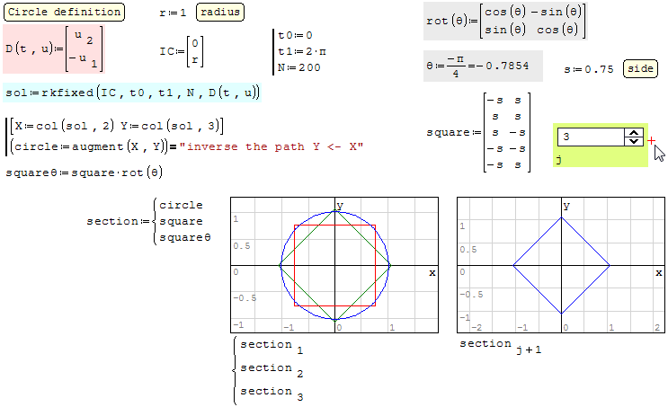

They have, both from canvas and from dialog. So yes, it is possible to elaboratesome degree of automation based on the inputs. If the roads are too different probably would be better to use collapsed areas with backed layouts however.
#5 Опубликовано: 09.05.2019 14:43:25
If I choose Rectangular, I have to inform a width and a depth.

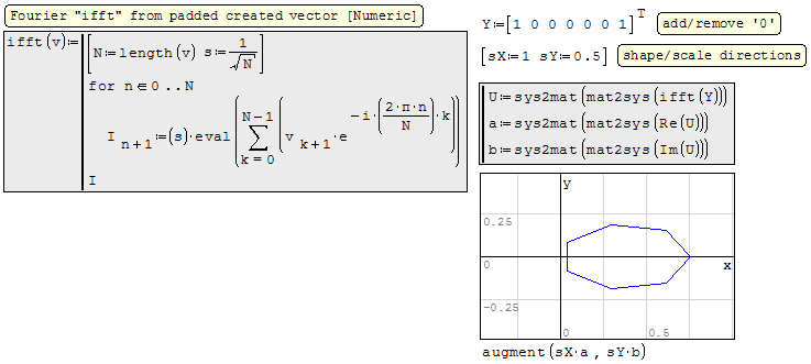

... add odd/even/shaped polygons.
