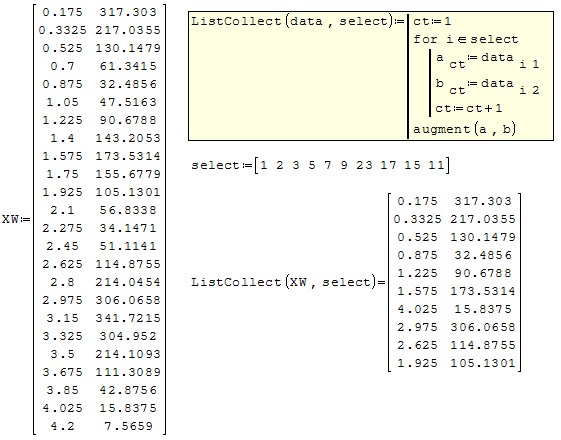

#3 Posted: 1/11/2022 1:51:29 PM
#4 Posted: 1/12/2022 3:58:49 AM
thank a lot, all options are excellent!)
#5 Posted: 1/12/2022 10:26:33 AM
WroteThank a lot, all options are excellent !
Appreciated ... more in there ... Jean.
Utilities Matrix Extractors.sm (56.76 KiB) downloaded 1143 time(s).

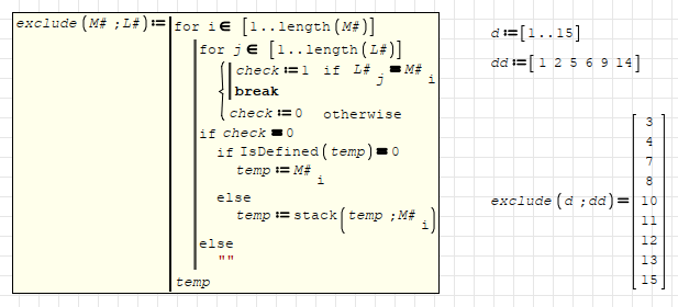

#6 Posted: 1/14/2022 3:06:20 PM
In addition to sergio's answer, you can use an custom exclude function.
It will remove substances of a L# list from master M# list.
exclude.sm (5.92 KiB) downloaded 1089 time(s).
