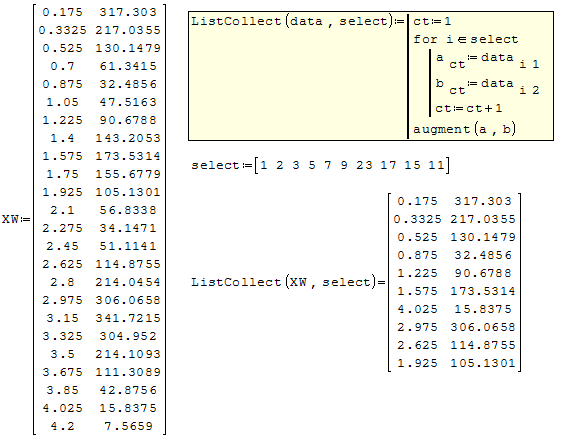

Utilities Matrix Extractors.sm (56,76 КиБ) скачан 1246 раз(а).
sergio 12.01.2022 11:17:00

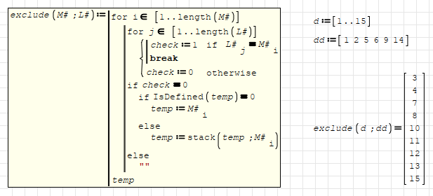

In addition to sergio's answer, you can use an custom exclude function.
It will remove substances of a L# list from master M# list.
exclude.sm (5,92 КиБ) скачан 1190 раз(а).
