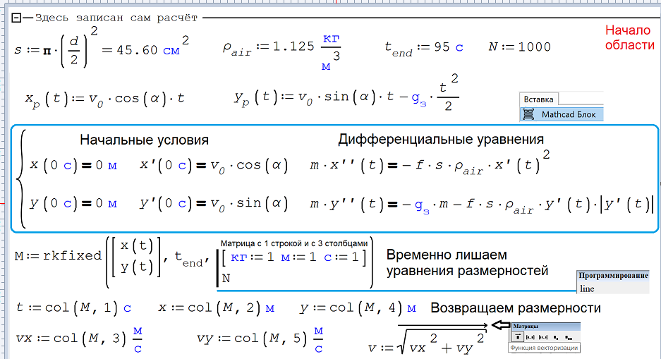

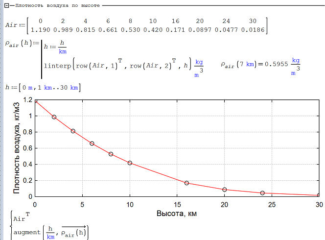

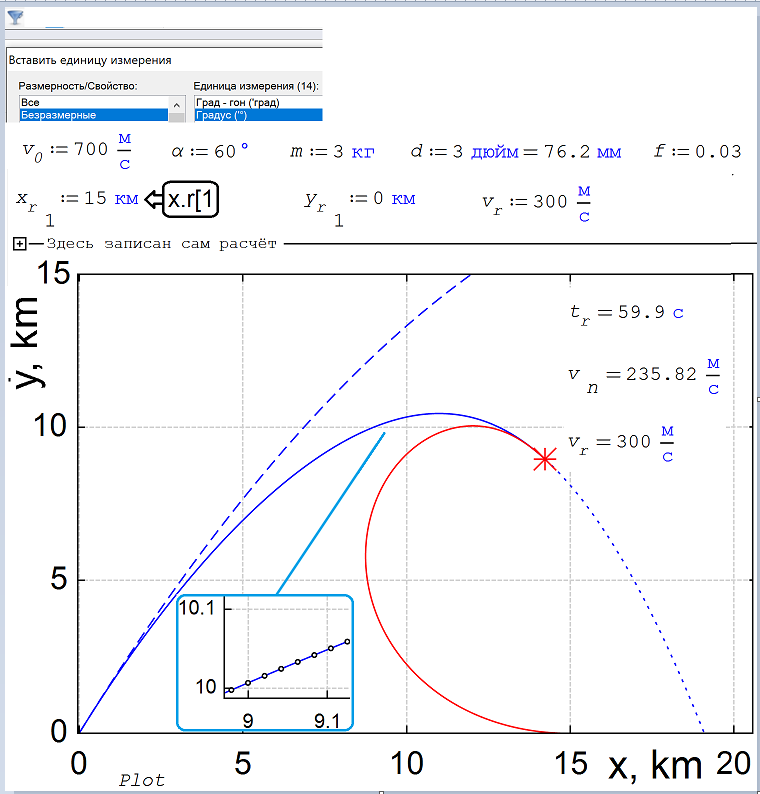

With air resistance
The article (Russian) Iron-Dome.pdf (642.75 KiB) downloaded 1383 time(s).
SMath-file IronDome-Air-h.sm (47.53 KiB) downloaded 1749 time(s).
