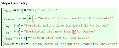

#1 Posted: 9/16/2023 5:01:44 AM
Ref: Example 12.2 (Page 296) - Soil Mechanics : Principles and Practice by G.E. Barnes.
The attached SM file demonstrates how to find cutting points of strips with the slope profile and slip circle.
(for an assumed strip width of 1m. which can be changed if necessary).
Slip_Circle_Barnes-Ex 12.2-TO FORUM.pdf (238.31 KiB) downloaded 935 time(s).
Slip_Circle_Barnes-Ex 12.2-TO FORUM.sm (320.99 KiB) downloaded 1637 time(s).

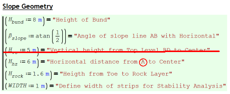

#5 Posted: 9/21/2023 7:45:50 AM
Please make the correction as shown ( replace A with -A in page 3).
Even without this correction, the program will run in most cases, but will give
wrong values for AA for some center cordinates.
This correction is an improvement.
Sorry for the inconvenience.
