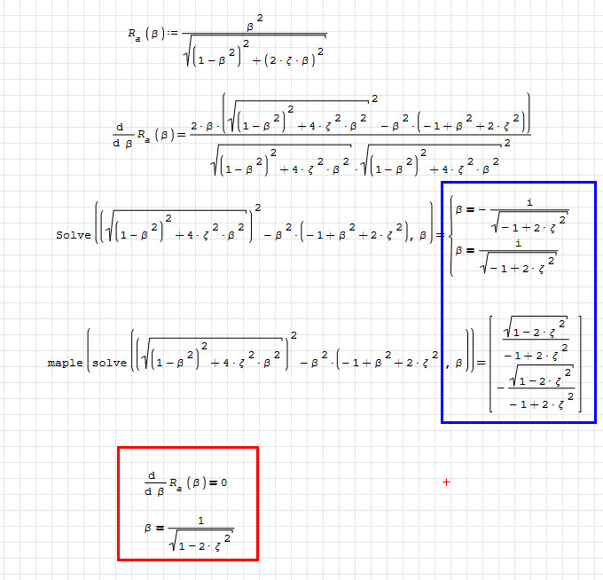

I want to get the real root in symbolic (in red frame) , but solve and maple solve always give me imaginary root (in blue frame).

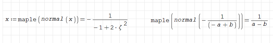

The answer is correct. The appearance may differ.
The appearance can be normalized, but it doesn't work in this case.

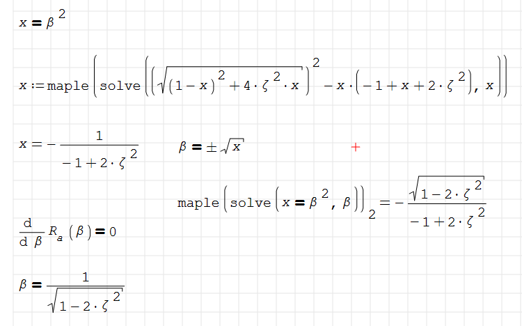

A simple option is force to find a real solution doing:
then...
best,
Oscar

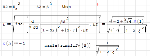

Hi. Using isol:
isol web.sm (223.27 KiB) downloaded 1301 time(s).

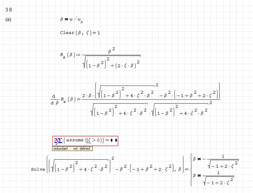

@Oscar Campo
I can't get answer as you show in the pic. Please see the attached.
real root.sm (11.49 KiB) downloaded 900 time(s).

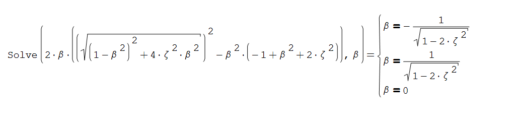

Sometime I do so:
