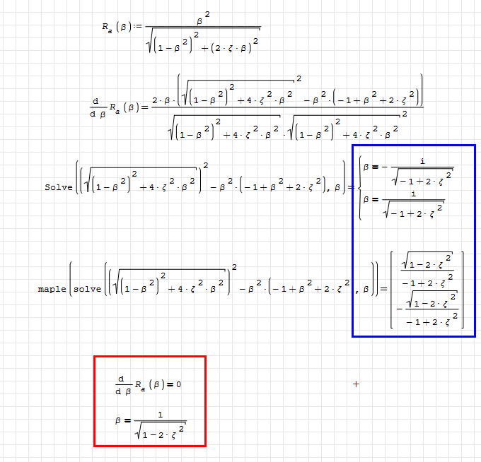

I want to get the real root in symbolic (in red frame) , but solve and maple solve always give me imaginary root (in blue frame).
Worksheet3.sm (14,28 КиБ) скачан 1310 раз(а).

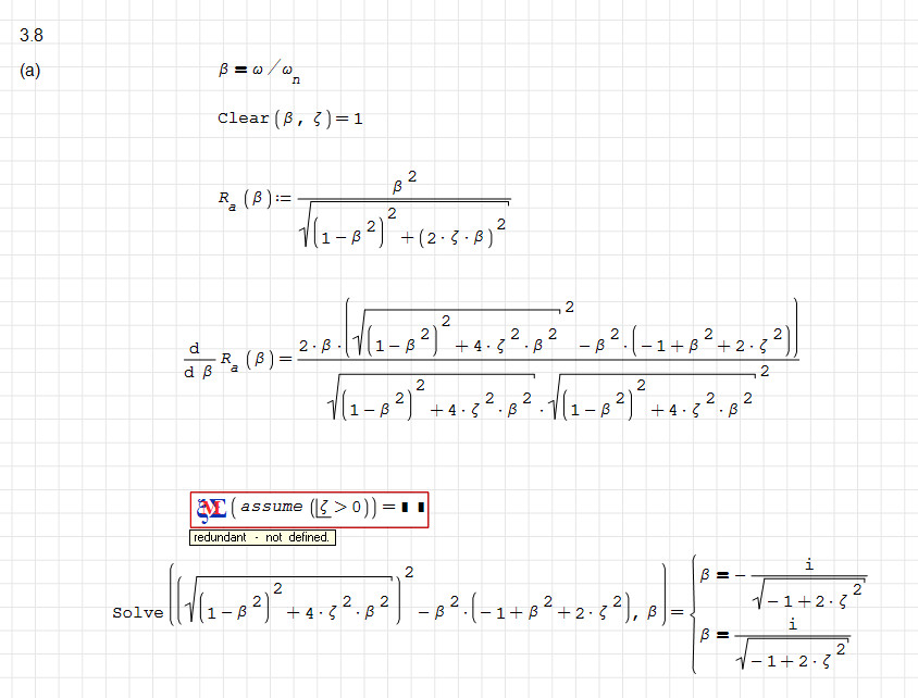

I can't get answer as you show in the pic. Please see the attached.
real root.sm (11,49 КиБ) скачан 901 раз(а).
