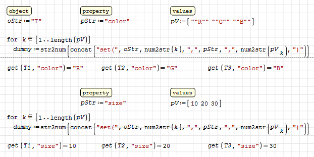

Hi. Something like this?
obj_set_get.sm (11,63 КиБ) скачан 1275 раз(а).

Hey Alvaro, that is really cool, I didn't know you could do that in SMath. Thank you

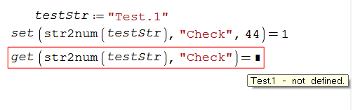

I was testing out your methods with the inclusion of loops and it seems that I can't create a variable beforehand and assign it, it has to be empty. Do you know a way around this?

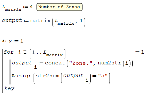

This is ultimately what I am trying to do with these functions, where I can get a mutable array of "Zones", each with their own properties (ie. area, x/y location etc.)

I figured it out, just don't know a way around it. Since I'm calling str2num(output_i), it's giving me the value of that expression and not the variable itself.
#6 Опубликовано: 19.01.2023 17:22:47
Yep. You need to call str2num at the worksheet level. Something like this
obj_set_get.sm (18,86 КиБ) скачан 1209 раз(а).
Also, I'm go to modify the code for accept set or collections.
