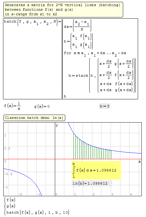

I open this topic for the snippets hatch and fill, as a place for further disussions.
You find these snippets and a corresponding example in the extension manager (online gallery).
Previous discussion can be found here.

Example of application
EllipticGears.sm (40 КиБ) скачан 253 раз(а).

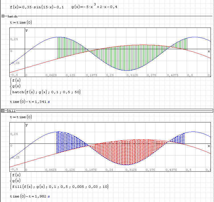

Two types of shading
Reuleauxtriangle1.sm (34 КиБ) скачан 203 раз(а).

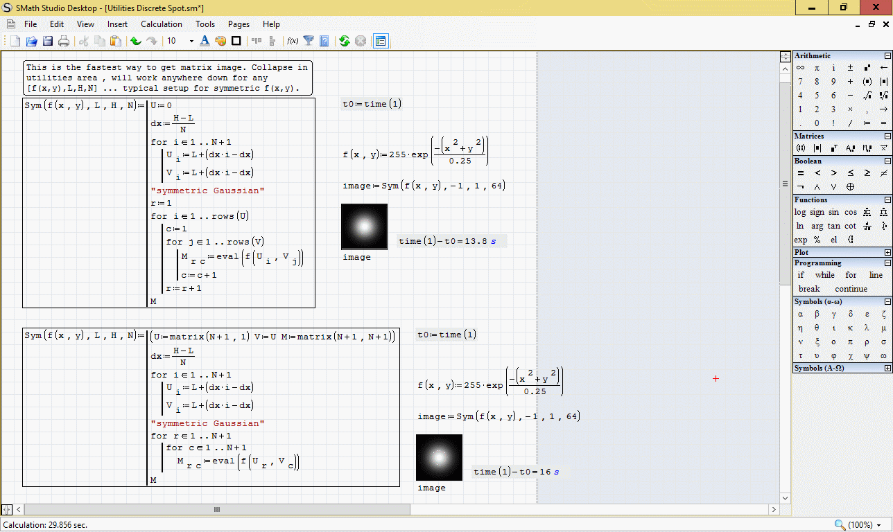

#7 Опубликовано: 9 лет назад
I understand that stack or augment are bad strategies, but without pre-allocation is better than with pre-allocation? If it is, why is without pre that good. Seems to be to much faster than I can explain or understand.
"memory allocation" vs "memory NOT allocation" is confusing to me.
Memory allocales itself from the construction. Visit the "Spot"
"stack" is very fast as being a vector operation. "augment" is slow
as not being a direct vector operation, but very fast within a program.
"hatch" creates a virtual matrix, a scalar matrix, i.e: a matrix at the
plot canvas. Same principle than plotting f(x) on the QuickPlot canvas.
Great construction, though I never used it. Watch it does not face infinity
governed by the N ... at infinity: it crashes Smath !
Forum Test Derivative.sm (11 КиБ) скачан 169 раз(а).
Utilities Discrete Spot.sm (12 КиБ) скачан 176 раз(а).

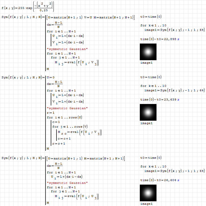

Using stack, if you have a vector, lets says, [x,y,z], then stack(t,[x,y,z]) must to force to push z from 3th plate to 4th, y from 2nd to 3th, ... for finally, put t at first place. And that's can take a very long time.
Preallocating is when you say "let's V:=matrix(20,1)", and then just work defining V[1, V[2 ... etc. If you found that don't need all 20 numbers, just can use submatrix. But if you don't preallocate V, but use V[1 ... V[20, and program work fast, who is preallocating must to be SMath, and that's isn't very efficient for the general cases. Or have some pointer very good for handle that matrices, and I don't know C at that level.
In your example, "Utilities discretes", it is suposed that defining U:=matrix(N,1), and same for V, must to be faster than having U:=0 and then use U[i

It is supossed that second algorithm must to be faster than your's, but it isn't.
Much faster than what? Please provide an example to discuss.
It's a common practice in libraries to pre-allocate some space for any container. Without this, it would be very inefficient to manage memory. Further, re-allocation strategies on the low level are quite efficient, because they either use % of current size to grow (typical are 2x or golden ratio), or linked lists that don't need reallocation at all. SMath doesn't need to do that itself, because it's .NET that does that for it. And it's VERY efficient for general cases.
Well, your slower second time could be explained like this:
pre-allocation in SMath is high-level operation, and it simply adds one additional high-level (slow) operation.
And it could explain something, if not one little thing ... actually it doesn't matter.
SMath calculation time is very volatile, and it's hard to measure time reliably, even doing multiple comparisons/calculations. E.g., processor temperature, that raises towards second calculation, may cause it to slow down to prevent overheating (contemporary systems do that). Some memory leaks in SMath may cause slow-down of all subsequent calculations (and when the sheet is done calculation, .NET garbage collection may clean it up, so recalculation shows the same picture).
Here is a screenshot that shows that your "second" calculation, put first, outperforms original.
С уважением, Михаил Каганский
Than I can explain or understand. Sorry, have not examples of that.
Thanks for the explanation, now I understand why mkraska says "The fastest way seems to be direct element adressing without pre-allocation". Because preallocating is with a high level instruction, and then is slow. Even I have the doubt about why NET pre-allocat V:=0 as matrix when user define that as scalar. I suposse that default SMath types are complexes, not matrices.
So, for the best practices book in SMath, which is best? Never preallocat? Or there are some size when NET take more time than SMath because the NET pre-pre-allocation (the jus't in case one) isn't enough big?
#14 Опубликовано: 9 лет назад
Mike Kaganski
Mike Kaganski
No, I tried to show this. One single allocation instruction's duration is null, zero, nothing. You will be unable to notice it in any measurements in SMath. Martin was not correct. I will say it once more: one method (assigning 0 and then addressing elements) is not faster than the other.
No, it "allocates" a scalar (very fast) once, and then re-allocates a vector with a sensible pre-allocated size (very fast) once.
I prefer always preallocating when I know the size. It won't hurt. Its "overhead" of high-level instruction is the same as of the assigning 0 and then re-allocating. In a function, it will not make any difference until the system preallocation size is exceeded, and then, when the function will handle big matrices, it will give you (insignificant, if any) performance gain.

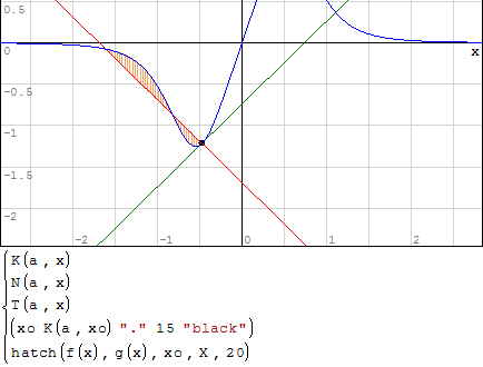

... works as expected !
Maths Tangent.sm (18 КиБ) скачан 188 раз(а).

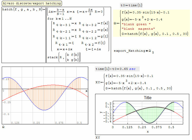

My versions for fill and hatch.
Have a nice day.
FillRnd.sm (44 КиБ) скачан 192 раз(а).

#20 Опубликовано: 9 лет назад
Alvaro Diaz Falconi
Alvaro Diaz Falconi
1 005 сообщений из 1 677 понравились пользователям.
Only the first module works. The ones "if/else" do not in Smath 5346
Well, works fine in last nightly build, but you're right, in others don't. I try to modify, but have a lot of issues. For instance, attached seems to work in last portable version, but can take a very long time for fill(phi(2), ...) , I suspect for some problem with the lele function. I'm interested in that function and rfill because rows of G are proportional to double integral of the functions f,g.
About the original fill function, it is a very nice job, but I prefer to define x range and Nx, Ny as number of points, instead of define the entire box x1,x2,y1,y2. But that's is ok for double integrals.
