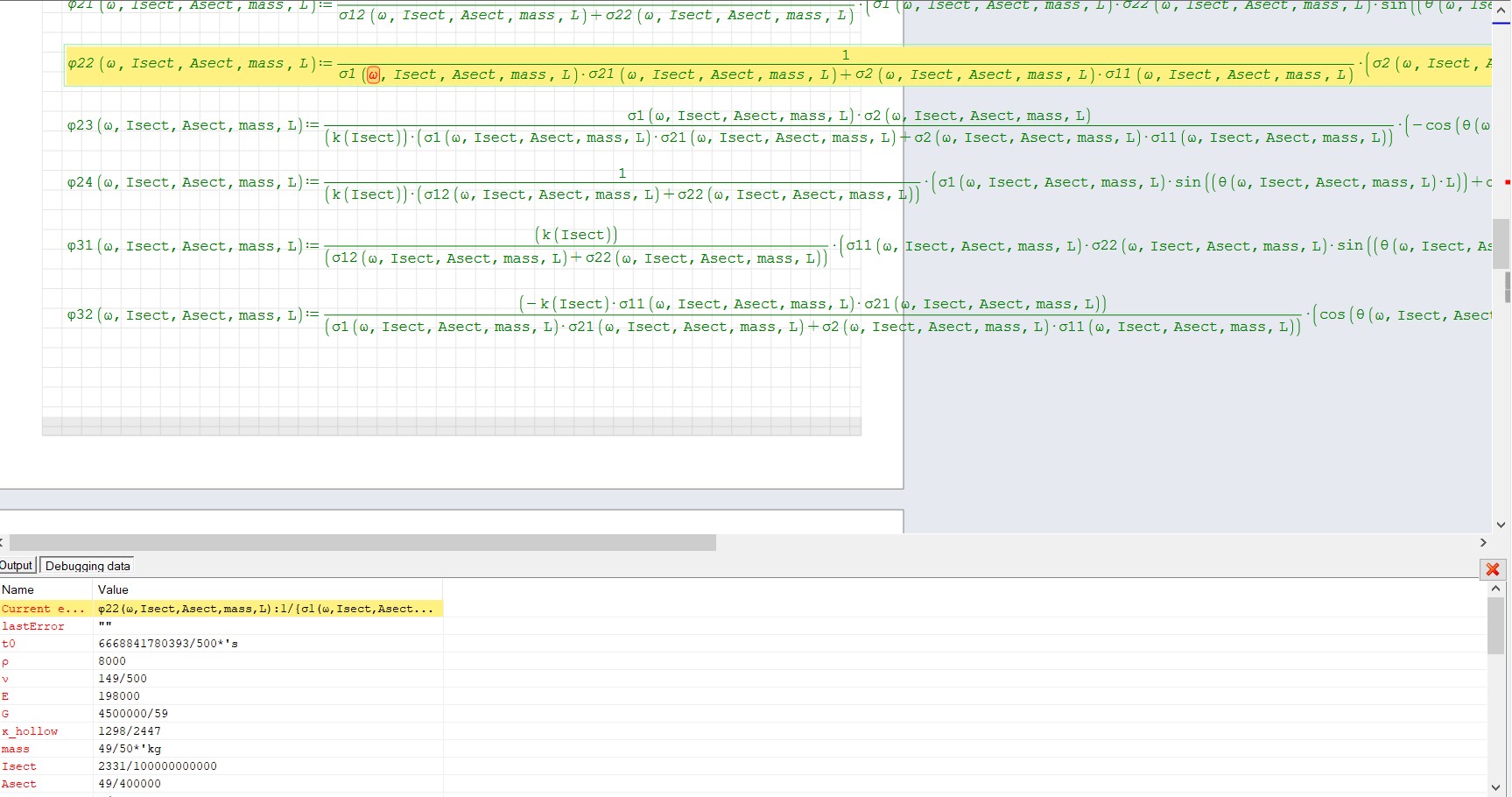

Hi JEAN,
I tried to run your last sheet (TMMT plot roots.sm) BUT a new bug (unknown until now) jumps out
for ALL my sheets involving TMMT algorithm (so, your sheet included....) : could you give me a hint
to solve it?
I'm very surprised and a bit upset: it's not matter of scientific calculation but debugging....
To be noticed that the bug involves SMath sheets previously working correctly (even if something was
signaled, randomly, in the past, for the same function BUT without any effect on calculations)
Many Thanks

Sorry JEAN,
I discovered in the meanwhile some flaws that I corrected: I can confirm no "complains" now.
BUT after more than 3h, SMath is stuck on detZ function....
What I ask you is to try to run the "modified version" here attached...Please stop
calculation after 1h running, particularly if, in this timeframe, the roots have not been calculated
: no need to make you also waste energy!
TMMT plot_roots V2.sm (147,49 КиБ) скачан 1643 раз(а).
Let me know : I think that I'm at the last tests before switching to MathCAD (for this problem at least - bending frequencies
of inhomogeneous stepwise beams) and, possibly, adding RAM to my PC (16 Gb is not sufficient in my opinion).
Thanks you very much for your support
Fabio

More, these methods are used mainly in preliminary dynamic&vibration verification (hence 5% error is more than good). By the way in one of the
original version of the my SMath file (ThreeHollowBeams_SteppedBeam) the calculation ended after 1h & 50' on solve (......) with the error message:
"No real roots"...I do not think it's matter of units (it worked in previous SMath files...). But on the other side, I do not know how could I ask to have even
complex roots...
Plus, do not consider negative axis and max the first 5 roots (lowest frequencies are always the most 'tedious' and a modal basis made by first 5 modes/frequencies
is more than adequate if we should want to consider an "answer" of the structure): this should limit the values (even if, to be honest with you, when I studied the same
cases in MathCAD, values of 10e18 were not uncommon).
Keep in touch
All done correct in few minutes vs hours.
Quick plot 10 min ... X_Y less greedy.
No imaginary roots encountered.
For 12 Decimals roots ... Dichotomy.
Explore from command line, or meshed data XY.
Jean.

Greetings,
Fabbro, to the best of my knowledge, the line() function bypasses some of the Symbolic calculations, so it has the effect of just creating a definition, whereas before SMath was attempting to define and symbolically process (and simplify/combine) ALL of the preceding equations into the current equation.
May this be of Good Help;

Oscar Campo 01.09.2023 07:40:00
I deleted most of non associated to document.
Every demand is greedy ... plots, solve, export.
At the point of Export, copy/paste in new sheet
for total independence, inspection.
Cheers ... Jean.

Hi JEAN,
thank you very much!! Really kind of you!! Me also I'm doing some test by myself with cross check
with respect to the expected results....yes, I'm doing a benchmark with respect to the following article
Response Analysis of Ladder Beams Under Inertial mOVING lOAD.pdf (788,69 КиБ) скачан 1353 раз(а). - See fig.2 and Table 1 (first example).
And it seems to me that not considering the units of measure has an impact on the expected results
In Mathcad and in the first, very manual, examples, the first frequency was got (around 5Hz); for the other frequencies
the method - that I baptized TMMT - revealed "stiffer" and stiffer (higher frequencies)...if you want to know something
more on this method please ask, it's nothing secret or new...simply forgotten...but I think TMMT has a distinct advantage
and it's "sold" elsewhere as particularly accurate for high frequencies...so, maybe, there is something wrong in the reference
article (that uses a much more complicated method in my opinion).
BUT all your work is really useful for me as I'm trying to "implant" many of your line in my original file (preserving units)
and results are promising. I'll keep you informed and exchange files.
Fabio
