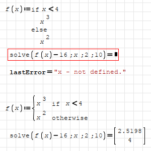

Update of statement:
solve(), roots(), FindRoot() doesn't like if() function.
However, they can solve when cases() used instead of if().

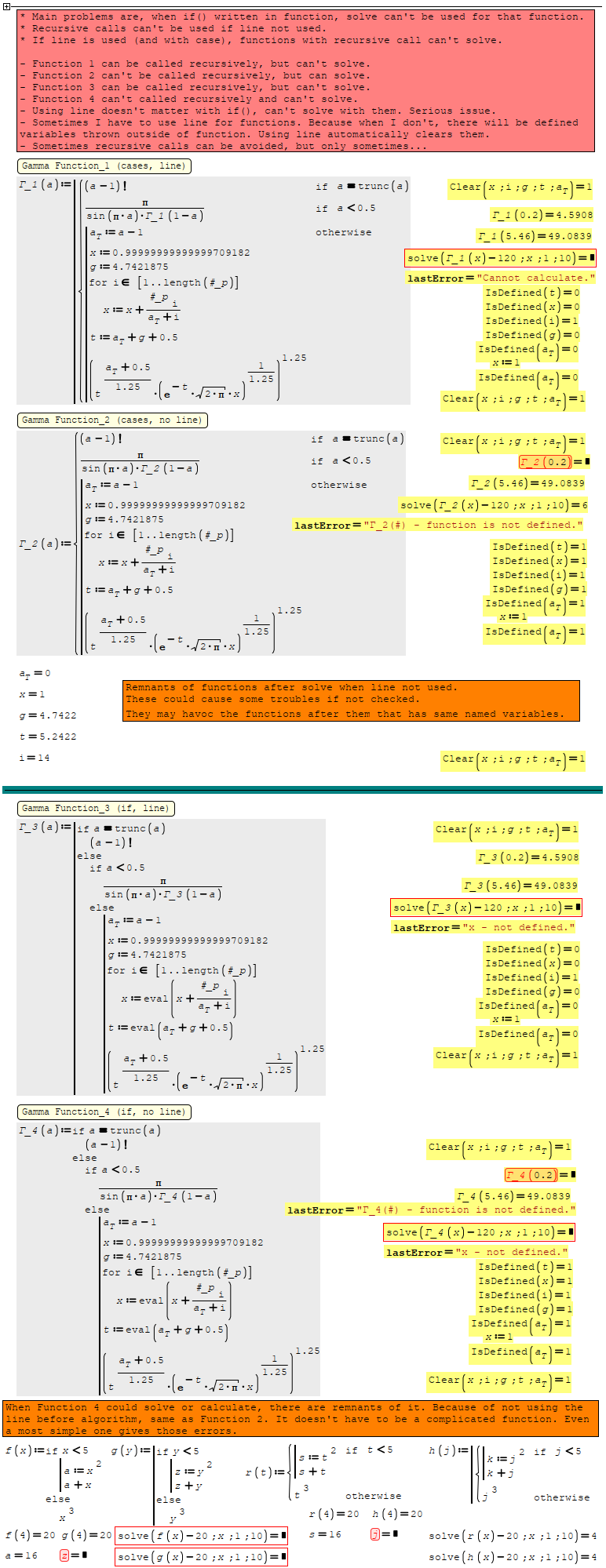

I have diagnosed the symptoms with solve bug.
Made a page about this and tried to explain with detail.

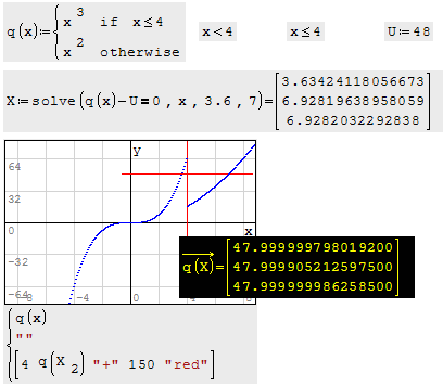

#5 Опубликовано: 12.06.2021 15:24:02
IMHO, its logical solving piece wise discontinuous,
solve piece wise as well for productive classroom.
Page3 Solve Discontinuous.sm (5,27 КиБ) скачан 1428 раз(а).

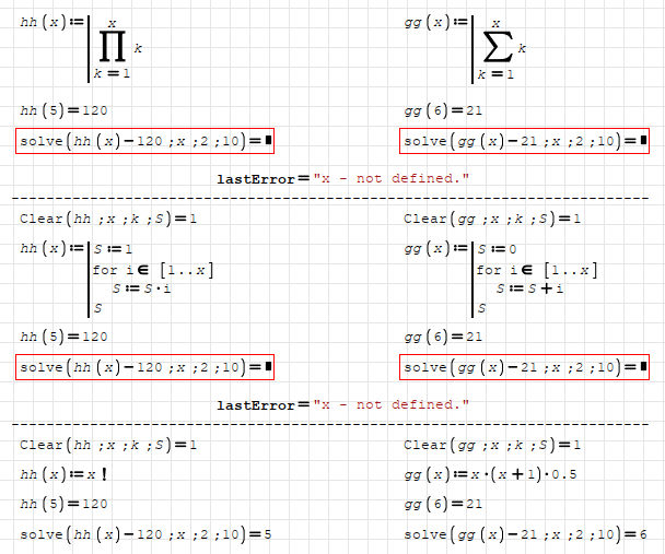

597 сообщений из 1 377 понравились пользователям.
There are other bugs too.
otherbugs.sm (13,7 КиБ) скачан 1193 раз(а).
