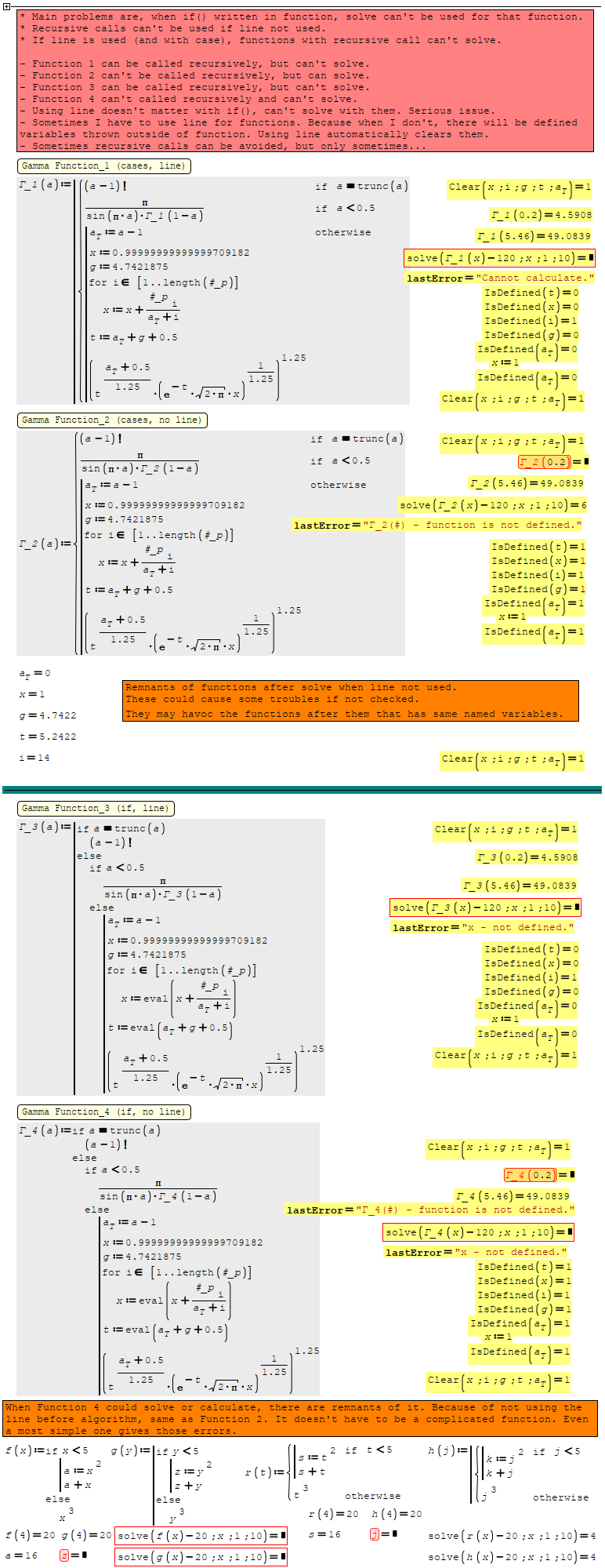

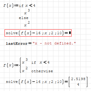

Update of statement:
solve(), roots(), FindRoot() doesn't like if() function.
However, they can solve when cases() used instead of if().
#2 Posted: 6/10/2021 11:36:37 PM
599 likes in 1,381 posts.

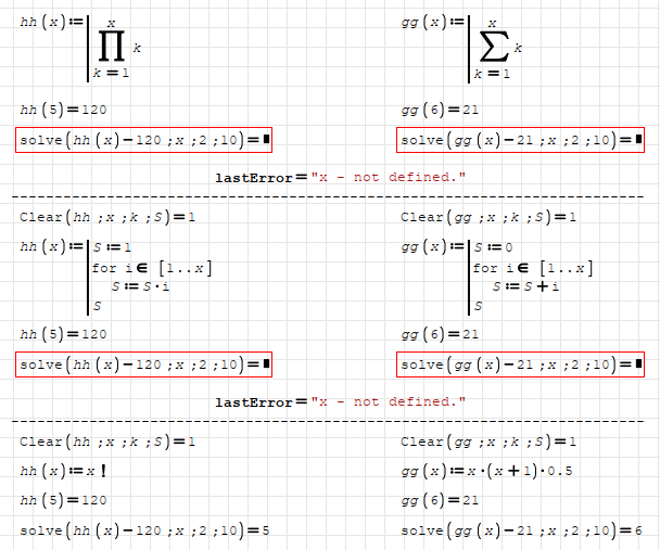

I have diagnosed the symptoms with solve bug.
Made a page about this and tried to explain with detail.
somebugs.sm (54.72 KiB) downloaded 1572 time(s).
somebugs.pdf (522.2 KiB) downloaded 812 time(s).

solve(), roots(), FindRoot() doesn't like if statement.

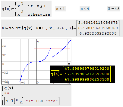

if/else was reported SS 5346.
Davide added if/otherwise SS 6179
Often, the solve bloc is ~ exact, sometimes exact
At worst 4/5 decimals.
Always start true Bolean #≤# ...
often won't complain incomplete #<#
From recollection, only DeBoor needs incomplete.

There are other bugs too.
otherbugs.sm (13.7 KiB) downloaded 1476 time(s).
